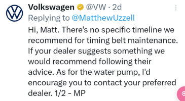

Hi. I'm new to this forum but really appreciating the experience and advice. I've got a 5yr old T6 on roughly 66k. Having read through this thread I'm starting to think I should get the cam belt & water pump changed as I don't know the history before 60k.
Thought I'd Tweet VW to ask their advice and got sent this (attached) which is really confusing. Also asked a VW/Audi specialist up the road and was told a change every 120k but no mention of time.
Thoughts?

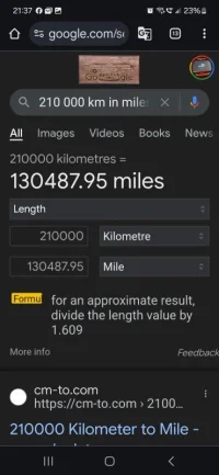

Dusty regions 120,000km is 74,500miles.
Normal. 210,000km is 130,000 miles.
