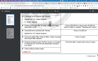

Because the VW workshop manual says do it at 210,000km without time limit, and the belt manufacturer says it was designed to last 10 years. See post #2 on this thread by @Loz. This is a UK only issue, all other markets follow the VW recommendation of inspection at every service and change at 210,000km without time limit. The issue in the UK only is that official dealers skip the belt inspection at every service.
Some early T6s had faulty belts. VW decided not to issue a recall, rather only advise owners who came into an official agency for service. A few of those who had service done elsewhere had their engines go bang.

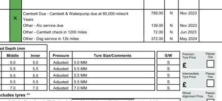

Although, I am a bit confused…..
The van was registered 22/05/2019 so by my maths it is 4 years old next week, and the job should be done at 4 years.
Not sure why then did the main dealer give me this when the van was serviced and mot‘d the other day…. says due November 2023 :rolleyes:
