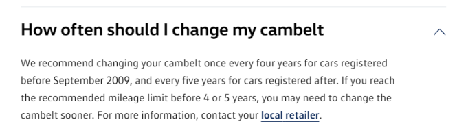

VW website ( but mention cars ) - VW Cambelts Frequently Asked Questions | Volkswagen UK
We recommend changing your cambelt once every four years for cars registered before September 2009, and every five years for cars registered after. If you reach the recommended mileage limit before 4 or 5 years, you may need to change the cambelt sooner. For more information, contact your local retailer.

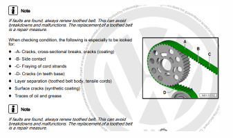

Cam Belt Replacement procedure -​
details new bolts that should be replaced.
The T6 2.0L TDi SSP-564​

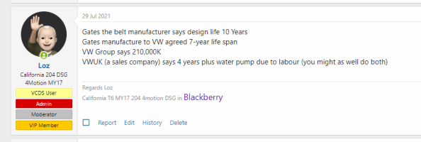

There's Gates official, VW official then VWUK official... :)
Loz said:
Gates the belt manufacturer says design life 10 Years
Gates manufacture to VW agreed 7-year life span
VW Group says 210,000K
VWUK (a sales company) says 4 years plus water pump due to labour (you might as well do both)

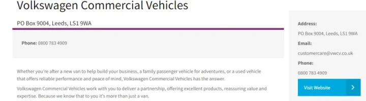

What is the contact address for Volkswagen Commercial Vehicles UK
PO Box 9004
Leeds
LS1 9WA
How can I contact Customer Care?
Customer Care details:
- Email: customercare@vwcv.co.uk
- Telephone: 0800 783 4909

Thanks for that BUT how does it stack up with the advice on the VW UK website which states:
‘We recommend changing your cambelt once every four years for cars registered before September 2009, and every five years for cars registered after.’
See: VW Cambelts Frequently Asked Questions | Volkswagen UK
