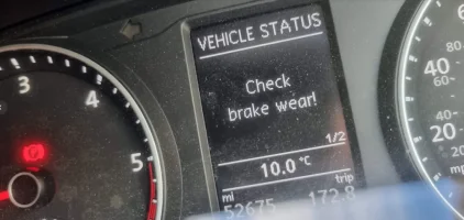

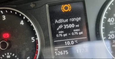

in the back of my mind i knew that the front and rear brakes have wear sensors of them, and that these come on when the pads are down to 80/90% - and i hadn't seen any warning yet.
so imagine my surprise when almost two weeks to the day, . . . . . this happened.
that message is triggered form one of the brake pad sensors, there is one on each axel. - its assumed that both side are changed at the same time so they save money and weight by just instaklling two sensors and not four.
OK no big deal, they are obviously due to be changed. were at 52k miles,
and i can see from my records that the pads were changed all-round at 29k miles.

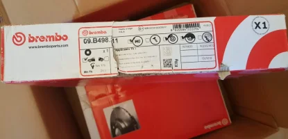

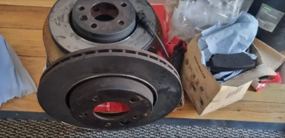

Now about a year ago, well, two by now . . . i made use of the BLACK FRIDAY sale and procured a full set of BREMBO pads and discs.
I've had them in the garage ever since . . . . . . 4x discs and a full set of pads.
larger 340mm front Brembo Brembo Brake Disc (Front)Product Code: 10444211A
340mm F Brembo Brembo Brake Pad (Front)Product Code: 10144186A
standard 294mm rears Brembo Brembo Brake Disc (Rear)Product Code: 10444136A
294mm R Brembo Brembo Brake Pad (Rear)Product Code: 10144131A

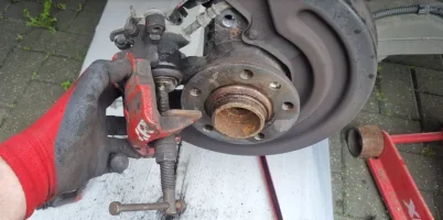

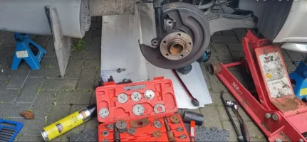

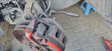

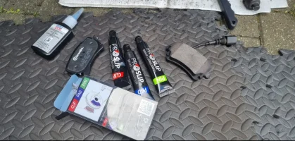

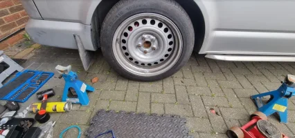

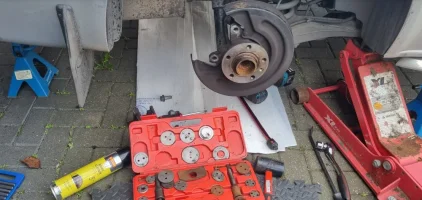

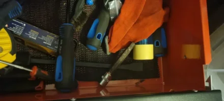

iv already got all the tools to do the job . . so lets that a quick look. . . .

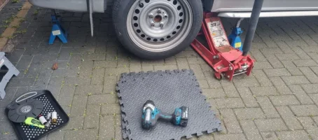

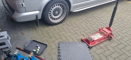

Trolley Jack and axle stands are standard, but there are a few extra bits you need.

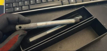

you will need a brake calliper wind back tool, i have the kit form as i do other pad jobs.
Brake cleaner is a must . . .
there is the 9mm long bit for the slider guide pin. . . . but i check that fully after.
Then some standard garage hand tools.
I decided to try this new little ProSlip Grease kit highlighted by a fellow T6F member . .
ill be doing the job soon . .
so starting this thread now.
