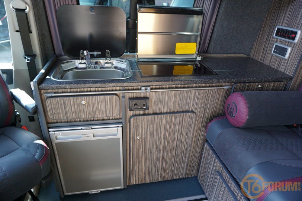

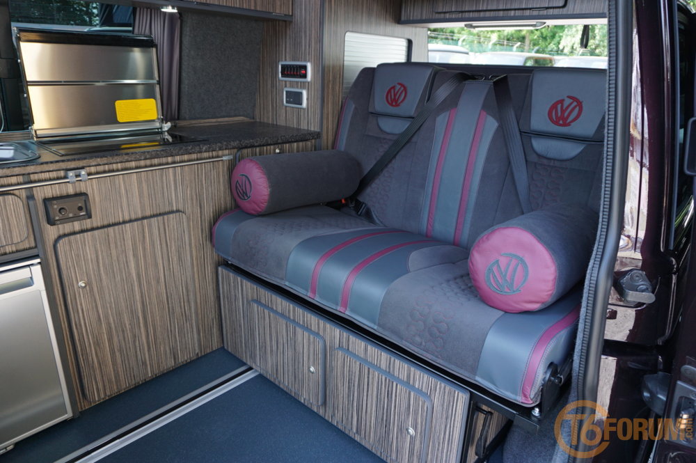

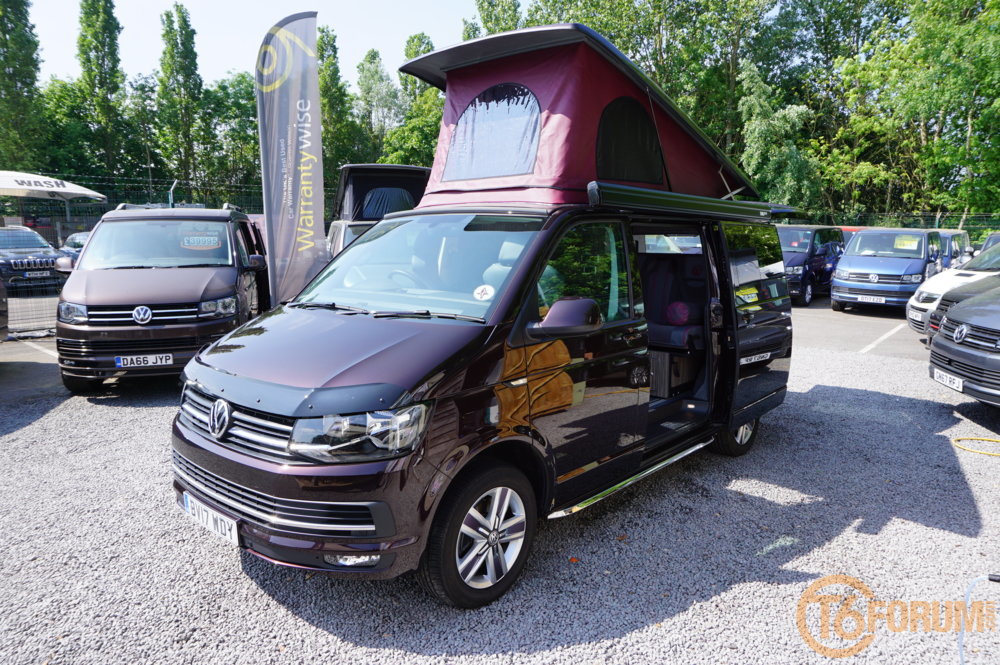

Ours was converted by Bodans (picked it up a couple of weeks ago) and overall no complaints from us, very pleased with the quality and their attitude to customer service has been excellent.
This is mine done by bodans.
Really please with the result.
Thanks to suggestions on here I have a switch in the B pillar trim that turns on 1 light above the sliding door this is handy for throwing shopping in etc without needing to climb across the van to the control panel. This has been the most used light by far.
If I was doing it again I'd only change a few things:
A light that turns on or can be turned on that illuminates the rear section when accessing van from the rear. I've found their current light arrangement doesn't really shed much light past the bed.
Possibly double their battery capacity or add another solar panel. Just to help with running the fridge and lights off grid for longer
Had a hole made in the base of the wardrobe so I can access the gas bottle tap without going outside and to the back of the van. I doubt your underslung tank will have this issue. I just like having gas bottle turned off at night, even with a gas alarm prevention is better than cure.
Possibly change the seperate sink and gas hobs to a smaller joined unit to create a bit more worktop space.
We find that you need to move everything off the tops to open the gas ring or sink. An extra bit of worktop would just help to store immediate items such as cutlery and plates to allow food prep on the table.
