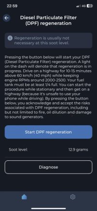

I don't know how to get the oil ash residue in Carista!
Just looked and the soot level in Carista corresponds to the soot level in the aft app:
That's about all I can tell! Should I be looking for something else in the Carista App?
