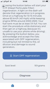

So tried a few different groups for my CXGB engine, looks like group 6 works best but will keep testing. The soot value matches Carista and the mileage figure and time is correct as I know I did a regen yesterday before driving the 5 or so miles home.
Yes. This is at full op temp. So an input and temp of over 500 deg C is realistic?
Indeed. That's typically when it's gearing up to do a regen where you could see temps go as high as 600C. Makes sense given your soot load. Expect a regen on your next trip out.
I’ll do a screen shot when fully warmed up/ready to regen- the one above was after just switching on
