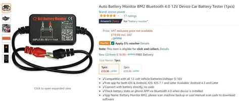

get a BM2 to monitor the battery state of charge . . (I've got one on the starter & one on the AUX battery)

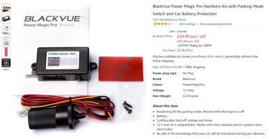

If the dashcam is the issue:
look at fitting a "power magic Pro" to power the dash cam.
it will cut off the power to the dash cam/s when the starter/Aux battery voltage drops to low - saving your starter battery. (at the expense of recording time)
About this item
  • Hardwiring kit for parking mode. Record while the engine is off.
  • Battery.
  • Configurable shut-off voltage and timer.
  • 12 V and 24 V compatibility. Works with most vehicles electric systems (cars and trucks).
  • Be safe in the knowledge that your car will be monitored during your absence.
they also do a USB BATTERY BANK, to sit inline with the dash cam to power it when parked . . . . but its pricey !!!
i think it would be cheaper fitting a larger or second Leisure battery in the van . . but you get the idea of what it is and what it does.
