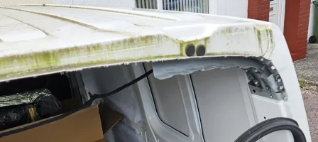

Excuse the grime, the van has been sat for some time, and it will be washed before and fettling begins.
Here you can see how thin this area is. There is nothing behind it, just the roof panel.
"It is only Wafffer thiin"
Hi again. Thanks for your reply. After checking further I can see some cracks on mine!!! Please keep us updated on your efforts, my van is going to need work to strengthen now
Has anyone got any other ways they have strengthened this area? Thanks

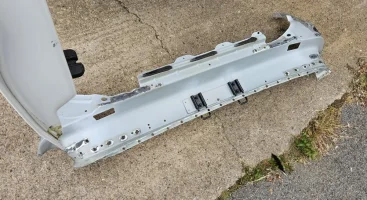

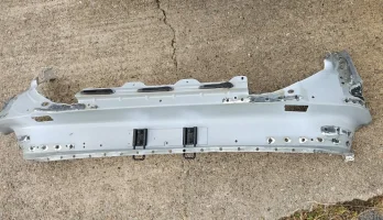

I started removing the panel (27) and yes it does get bent and buckled in the process. There is quite a bit of bonding hidden along seams as well as all the spot welds so a lot of prying and bending to get it off without damaging the panels its bonded too. It can be repaired for refitting, but a lot of work in that alone tbh, may be more cost effective to get a new one. Knowing you have a new one will speed up the removal as you can cut the panel as you go to make it easier to get out.
The most effective way i have found to tackle the spot welds is by drilling a pilot hole all the way through the middle and using the small hole saw type spot weld cutter.
I first tried using my spot weld drill bits, the flat cut face type with the center pin, but due to the panel being mostly curved the bit would wander and walk making a right mess, and not getting all the weld cut.
The hole saw type is supposed to be used in a similar way, the spring loaded center pin pushing in to allow the cutter to engage, but these wander even more. If you drill straight through, the cutter stays in place and cuts cleanly through.
I got the panel off, roughly 2 hours to do (over a few evenings when i had a spare 20) you could probably get it done in an hour if you were young and nimble and had enough time in one go. My shoulders are seriously aching from all the drilling, especially as every spot needs drilling twice (pilot then core).
Parcel Force are saying wednesday for delivery of the inner panel. I ordered it on the 8th, hard to believe that companies can still take this long to dispatch a stock item, even if it is in europe. Maby I'm just to used to amazon prime
Yesterday i ordered a new replacement for this panel just removed, as i kinda mangled the first side i started at, so probably be another 2 1/2 weeks till that arrives.
Obligatory pics....
