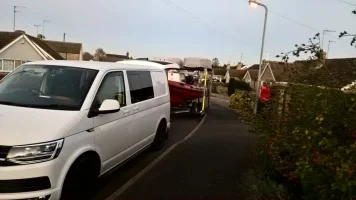

@Dave Harris I can only think that it has to be a spring issue, as this is my T32 which just has lowering springs on at the moment, rather than uprated dampers (Bilstein B14's planned).
There is next to no deflection on the rear suspension.
That's with a 5.4m ribquest, and 2 optimists on a big ass trailer, plus all the spars, foils, trolleys, bags (and kitchen sink) in the van.

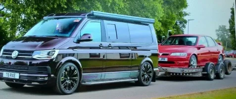

Mines On H&R heavy springs all round, weighs in at 2700kg fully loaded. Tows like a dream too.
Guessing your nose weight is still only around 75kg though? For me the issue seems to be a fully loaded camper, with trailer, plus bikes hanging on the back adding to the weight over the rear axle. As above, not overloading but position of weight is bringing the back end down. Fix I'm pursuing is VW's recommended PR no 2MK (whatever that may be - any luck @Pauly ?) if not available (or the same thing) I will source some T32 springs and get swapped out.
