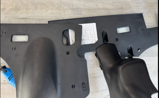

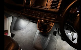

I have bought some of @saxoboy ’s lighting kits and yesterday, whilst ‘working’ from home I decided I would start with the footwell lights.
Easy to follow instructions, nicely put together kit. I probably spent maybe half an hour putting it all together in between doing other bits and bobs. Fishing the cable through the bottom of the dash was probably the most fiddly bit, but once you find a gap, you’re away.
Just the one issue, which was down to operator error
I removed the trim end panel and left it loose on the airbag cable. The wind blew the door shut and the next thing I heard lots of bits of plastic hitting the deck. The airbag switch had become detached and fallen apart.
Fortunately it was easy enough to put back together.
I normally disconnect it because a) they’re not a problem unless you turn the ignition on when the switch is removed and b) I’ve got VCDS, so can clear the fault. Lesson learned that is….
They’re bloody bright as well. Pic to follow.
Just the door lights to follow next.

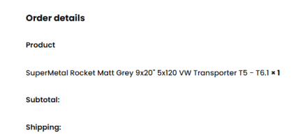

Well....

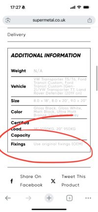

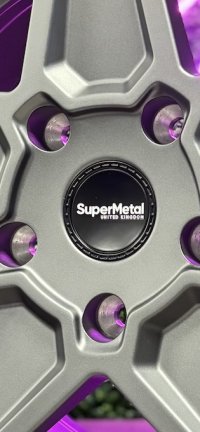

I also like the simplicity of the 6P but what swayed it for me in the end was that the SM wheels are flow formed (I know technically, they're still cast, but the "flow forming" process does make them slightly lighter and stronger), they are 9J and ET45 so identical to the other wheels and they also have a radiused seat so the standard wheel bolts can be used.
I'll probably change my mind in the next few days, but for now I better get some tyres ordered.
I think I've spent about 60 quid less than I was planning to...

Are you 100% sure about using the OEM radius bolts as I cant find anything on the Supermetal website.
I know it’s difficult to tell from a photo but that does look more radiused than tapered
