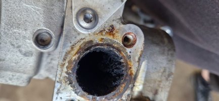

I am getting ‘insufficient flow’ on the EGR, so it might be time to swap it. I really don’t want to blank or map it out as I believe, like the DPF, it’s there for a reason and I want to keep it that way.

EGR done - was clearly mucky and had a reached a stage where the spray cleaner would no longer do anything.
I bought a Wahler version from GSF, which came in a Borg and Beck emissions system box and cost £360 - less 15% discount and less £108 surcharge for sending the old one back so it topped out at £250 ish. I paid £120 to have it replaced including the antifreeze.
My tech said it was a pain in the arse of a job and it had clearly been done before, because it was missing the two inside bolts. It was also Valeo branded, which indicated to me that it was also aftermarket.
Didn't take any detailed photos or split the cooler from the valve unit.
