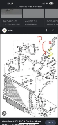

Carnt find if red marked pipe goes to matrix. , as bottom hose cold and no dsg cooler pipes are getting hot

No kinked or crushed pipes, the diagram looks like that may connect to matrix or components ..?
no.4(rubber pipe) & no.43(hard metal pipe) in diag. look heater connections ... ?

Only 1 matrix pipe is getting hot. / bottom hose cold / dsg pipes cold Usely water runs threw matrix on start up so heaters start to warm / waters bubbling in header and heaters still cold /
Bloody engine out the change water pump / I’ll check thermostat ( which is another task on its own )
