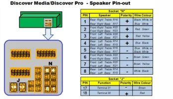

I recently installed aftermarket amp + speakers with factory radio. Factory radios have build in speaker monitoring which perform basic speaker check on bootup. My J794 output is now going to high-to-low converter which triggers errors...
