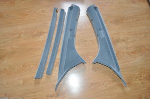

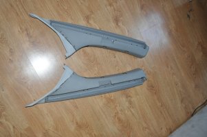

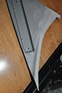

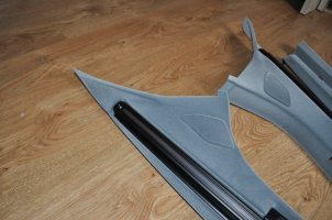

Hello, after reading the topic I started to match REMIFRONT T5 to T6. I used T6 post covers for this purpose, cutting off the appropriate piece and gluing it to REMIS. Of course, reinforced with resin, putty and flock on the external surface. The work time was about 3 days, 2-3 hours each, it was not difficult, but time-consuming.
