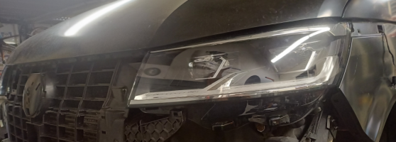

Then I put in the headlights, it took some adjusting to get them in a somewhat right position, the final adjustment will be done when everything is back together.

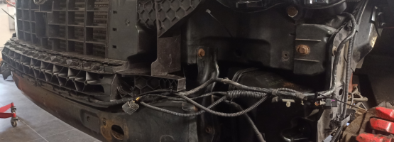

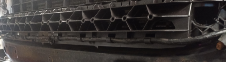

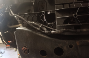

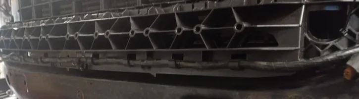

Then I put in the wiring loom going from the left headlight, across the grille support, to the right side of the bumper where it connects to the wiring for the right headlight.
I used zip ties to tie off any loose wires for now as the van will be going to the painter before complete assembly.

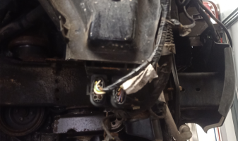

I connected up the headlights using the adapter module and I made custom support brackets for the module to sit on.

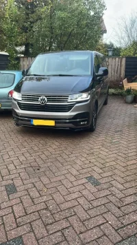

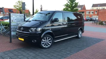

Before:
After:
