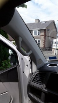

Thanks for the instructions. The pics helped me to orientate the handle, and double check where the holes needed to be drilled. I did not have to remove the plastic fitting completely - it was easy enough to fit the base plate with the a-pillar fitting intact. Hint. Use a measuring tape to measure the location of the handlebar holes and then copy to the plastic fitting. Drill the top hole first, align the hole using a pin, and then drill the bottom hole. Once drilled opening up the hole with the small blade of my sharp Victorinox pen knife was easy. Now my wife and parents are happy☺

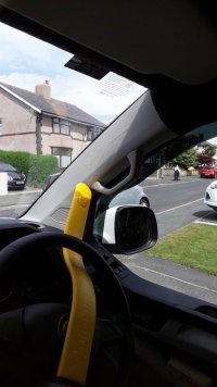

I did this over the weekend. It was really easy, just be careful a patient cutting the holes in the trim, obviously.

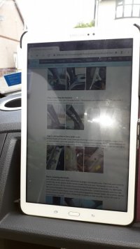

Got some pics, what stuff did you use?
IMG_3907.webpBracket and handle from eBay
Gentle getting the trim off then loads of pics on this thread helped me locate the right postion for the bracket
The A pillar has markings showing where to cut the hole.
I used a drill but better with a small pilot hole then something like a Dremmel a maybe even a rasp or file, to keep the cut out round .
Was far easier than I thought. The marks on the A pillar saved me a lot of worry about measuring the hole

Wife loves ours as she is small so helps her get in. Looks nice as well.
