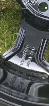

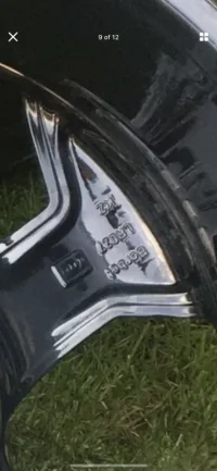

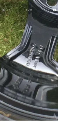

After advice if possible. Im getting a T30 which im converting into a camper and have been looking at loads of wheels. Want gloss black and have seen bmw tiger claws and range rover wheels a lot and quite cheap.
I've seen some that are 8.5j x 20 and are on 255/55/20s. How would these fit? What would i need? I've shown pics which i hope show all the info for you to provide the above.

The tyres are too big but the wheels will fit with correct size tyres...

245 is a perfect width for 8.5”.
Choose a profile and load rating that fits your needs.
I have a 45 profile, but that is as big as I’d want to go and means my Speedo under reads by 1 mph at 60. But I’m T32 so less choice.
Being T30 you only need 101load rating I believe. More options for you.
Look on ‘will they fit’ (google) and compare to get a better idea.

I can't make out a load rating in those images, but you need to have a minimum load rating of 805kgs for the wheels. Bolt PCD needs to be 5 x 120. Centre bore needs to be a minimum of 65.1mm, but can be more if you use spigot rings. You need 101 load rated tyres as a minimum, and on an 8.5" wide rim, your best choice is a 255/40 R20 tyre.
The 255/55 tyre is far too big for the T6 and is likely to cause some rubbing, even with a van at standard ride height.

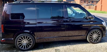

Hi all
First post in this forum, having just joined anyway!
We moved from a T25 to T6 camper last year - a different experience but more reliable!
The T6 came with 20” wheels which look good but are just too much for anything other than smooth roads.
Also I think the speedo is under reading, based on satnav and being flagged down by traffic police recently!
So I want to swap to 18” .
Currently got Wolfrace Assassin 20x8.5 no idea of offset. Tyres are 245/ZR40 106 load rated.
It's a T28 so wheels and tyres are well in excess of axle weights.
I can’t tell if it’s been lowered at all.
I’m in Lincolnshire - does anyone have any recommendations for someone to do a wheel swap ensuring suitable wheel size and offset etc?
I’d be happy to do part exchange as I don’t really want to be left with wheels and tyres to sell.
Wheels good and tyres done less than 7000 miles.
I do like the Wolfrace look though not that fussy!

Hello and welcome!! Lovely colour ;)
Looking at the height I’d say that it has not been lowered.
I can’t recommend anyone for wheels in your area.. but i can recommend a few online companies that will help you out with offsets and tell you what they would recommend so they sit perfect! I have dealt with all three of these.
Tamar Wheels - various wheel types including alloys and steels
Wheelbase - various wheel types mainly alloys
Duchy banded steels - the only person for you steel wheel needs. These fit spot on.
You can also use a website called https://www.willtheyfit.com/ this will show you what your current set up would look like against your new one And you can play about with the numbers. It will give you an idea how the sizes will affect your speedo.
