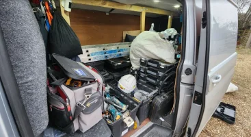

It is a Jet Rack. It fitted nicely in the Transporter, certainly easier than the ones I fitted in our Transit Connects. I bought their universal mounting kit which has captive nuts for the unistrut to screw into. I took out the roof panel, used a laser level to line the plates up on each crossmember, and marked where the crossmembers were with tape.
I then refitted the roof panel and used the tape and laser line to mark where the captive nuts were on the panel. That way I could take the roof panel out again, put a 20mm hole saw through on the marks. Fingers crossed, the holes line up with the captive nuts, and you can then refit the roof panel and then fit the unistrut afterwards. I also trimmed some of the trims that go in between the roof panels to accomodate the unistrut.

No worries, I've fitted a few now but I remember the first time I fitted one I thought it was a real PITA and a lot of F'ing and Jeff'ing. If you need any more photos or whatever then I can take some, but I'm not wrestling the roof panel out again, sorry!
Something worth noting is that all the fittings are imperial and so if you lose any fixings you will need to find somewhere that sells imperial. We lost one of the nuts off the back of the hanger once, luckily one of our customers is a fastener company and let me pocket a replacement!
Edit: Oh and definitely lube up your length :slow rofl:using some white lithium grease, transforms the operation of it.
