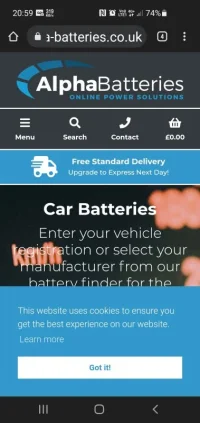

I got mine from Alpha Batteries
Their prices are good and it’s easy to search with filters.

Alpha Batteries are a good place to start.

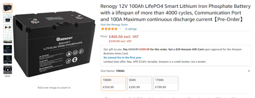

i would recommend getting Lifepo4 . .
for the same size a 100Ah lithium is effectively two of those 100ah above . .
dont forget you can only use half of those SLA capacity of power.
id get a Renogy 100ah ( i have one of these) . example - 12V 100Ah Smart Lithium Iron Phosphate Battery【Pre-Order】

get a 100ah Lithium battery to swap out your AGM one, like this - https://amzn.to/3oaKvrg

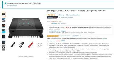

then swap out the Sterling DC-DC charger for the, Renogy DC-DC with integrated solar MPPT - Renogy 50A DC-DC On-board Battery Charger with MPPT : Amazon.co.uk: Automotive

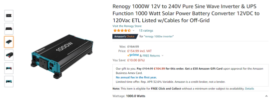

Now add the Renogy 1000W inverter - https://amzn.to/3lsF4T0
or the 2000w inverter - https://amzn.to/3xKj6Q0
job done =]
Remember that Renogy recommend using 100ah battery per 1000w inverter,
so that 2x 100ah or 200ah batterys for 2000w
