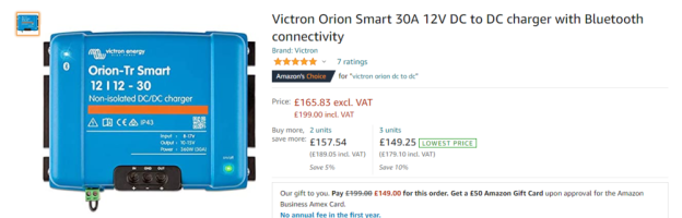

Then get the Vic` Orion DC-DC charger (30A) - Victron Orion Smart 30A 12V DC to DC charger with Bluetooth connectivity: Amazon.co.uk: Electronics & Photo

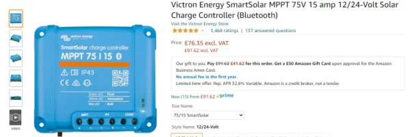

add a solar MPPT to the mix, ie a 75/15 - https://amzn.to/31dYLXj

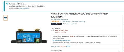

add a smart shunt if you wish . . . - https://amzn.to/3lsGo8q
