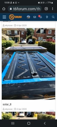

The fundamental problem with panels bonded to a roof, is the difference in expansion rates between the panel & roof. If the panel expands faster (it will, because it’s black & is the first thing the sun hits, it’s basically shading the roof & keeping it cooler) then the panel will try to buckle, because the roof is preventing it from expanding. Over the day, the roof warms up & expands. When the sun goes down, the panel is the first to shrink, but is being held back by the now expanded roof. The metal components in the roof shrink & cracks in the conductors start to form.
A panel that is mounted so it can float, will expand & contract independently of the roof, hence longer life. Plus rigid panels are glass, not plastic, so thermal movement is less.
This is the reason why I mounted mine to 4mm twin wall and then bonded the twin wall to the roof with double sided tape, the panel is not affected by the roof warming at a different rate to the panel
I am looking at this as my current panel has failed and will need to be replaced. I do not want to replace a panel every two or three years. I will probably go down the same route by using 4mm twin wall, how secure is the 3M tape? Any sign of lifting due to rain etc? Can you tell if the panel has any movement to allow for heat expansion?
