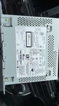

Hello is anybody able to tell me if my media system is compatible with installing an aftermarket reverse camera to show up on the screen?
I currently have reverse sensors in the bumper.
I've attached a pic of the serial number
Unfortunately it requires a expensive interface as it was not designed to have a camera, and a NSTC camera
Thanks for clarifying that. I'll have to look at an aftermarket media system as would ideally like to have a reverse camera.
