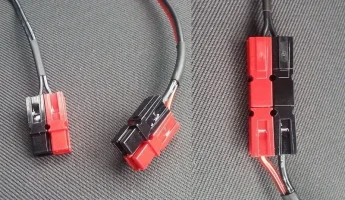

its an SAE connector for the 12v fridge source.
Takes up less rear space that a conventional Cigarette 12v socket but you need to watch out for polarity as there does not appear to be standard for right or left positive. In my case the positive red on the male was on lhs and in the rhs for this female SAE.
Look up Anderson power pole connector.
You can get wall mounts for them too.

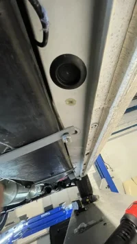

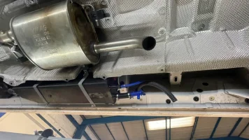

I did a skirt tank from CAK Tanks. On the plus side - it’s 21L, and fits in the gap. They also do a 17 L option for under the drivers step, and they are the only ones I’ve found that make for this location. On the downside, CAK tanks are as shambolic to deal with as their lousy website suggests.
Once they manage to get you a tank with the connections where you asked for them, fitting is fairly straightforward, despite their terrible instructions.

Cheers, drivers step location is no good for me as I have the factory fitted Eberspacher heater which sits in that location. Although yours looks quite far back.
I am very tempted by that 70l tank that sits in front of the spare wheel well though...
Might need to add it to the list, and find somewhere who'll let me borrow a car lift...

Yes, I’ve got a heater too, so no step tank for me. 4Motion rules out the spare wheel location for me, but if you are FWD that would be the best option.
I spent months trying to find a ramp, and then it turned out the classic car storage place right next to my van storage did one! There is a place in Medway that might be closer to you. It is possible to do it without a lift, but a thoroughly miserable experience.

@TallPaul_S - Would these be OK to connect to a leisure battery to enable charging from a portable solar panel?
Yep, either power pole connector
Or the SB connector
Just make sure your cable and the connector amp rating is correct, the Anderson plugs come in a variety of ratings. @Dellmassive uses the SB connectors for all his DC-DC charger testing etc.

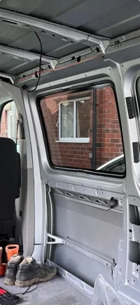

How are these hung please? Self tappers into the steel?
I took the ceiling down, screwed a 40x40 timber batton in sections to the vertical face marked with a red line here. Rear fixings go into the metal shell, front fixings into the batten. This photo is from yonks ago. :thumbsup:

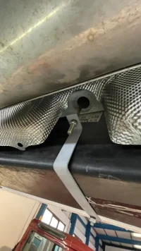

From experience I’d recommend some channel rubber on the support brackets where they contact the tank and Nyloc nuts on the securing fasteners.
