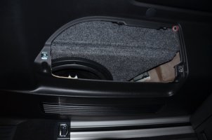

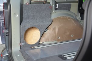

Subs inside the tailgate, either side?
Tbh if I was looking at fitting a sub, something like this would be my choice
It fits inside the caravelle plastic trim!
It replaces the space in the jack compartment, which lets face it, is a useless jack anyway...
I think an Alpine speaker upgrade, and maybe an amp later down the line, will be perfectly good enough for me.
