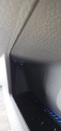

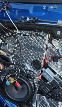

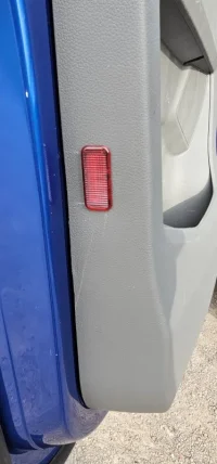

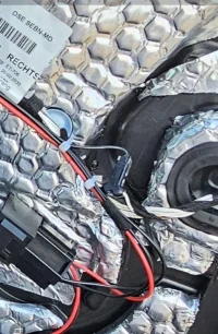

So passenger side done and having thoughts last night so a little addition
Which means I can
View attachment 282707View attachment 282708
Or if on site and don't want the lights getting hot or draining the starter battery
View attachment 282709View attachment 282710
Will do the same to drivers door when I get a minute but pleased with the result
Hi Matt,
Where the power is coming from? Did you take it from any existing into the door point?
TIA
Hi Matt,
TIA
It is all coming from in the door. Main white wire in the door module for positive. Door Earth point. And switched negative from door catch. You'll need a multimeter to determine the switched negative but quite easy.
