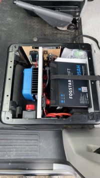

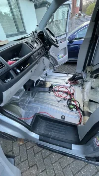

Moved DC-DC charger, Fogstar 105ah battery, shunt and Ablemail AMT12-2 from rear wardrobe to under the single passenger seat to free up storage room in the back. The mains charger will also be moved to under the drivers seat. I also tidied up the busbars, cabling and CBE fuse box in the wardrobe to get them out of the way. While I had the front seats and mat out I took the opportunity to add a layer of sound proofing too. Next job is to fit the solar panel, MPPT and also add extra 240v socket for the mains charger. I also want to change the front power sockets to the ignition circuit and swap at least one to a USB socket.

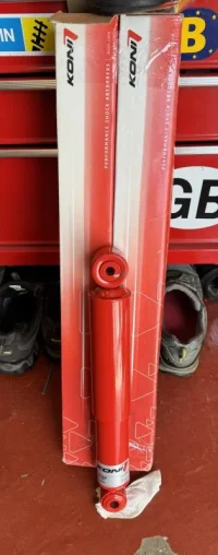

This week actually. Wheel arch plastics off, jet wash, repaint, wax and calliper's going matt black. Front and back. Front end I replaced everything last Spring, now time to replace out the Caravelle springs for t32 3x grey in theory stiffer and +20mm to std ride height and now Koni shocks on the back
Ride is really good first impressions. Job done

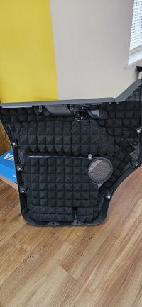

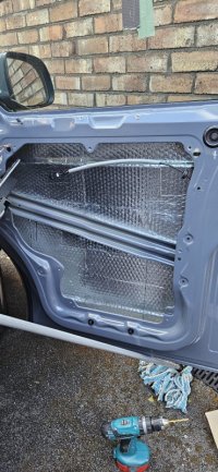

Fitted new alpine speakers & tweeters , sound deadening doors and cards plus 5mm foam backed door cards , truly amazing sound after figuring out the best equaliser setting , can't fault the quality of these speakers .
