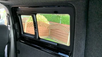

Fed up of leaky side windows so had 2 x CamperGlass / TransporterHQ flush sliders fitted today. I used Midlands Vehicle Glass (mobile fitter) and am extremely happy with the service. Bottled doing it myself and having seen him work and the tools he used I'm glad I left it to the professional.
