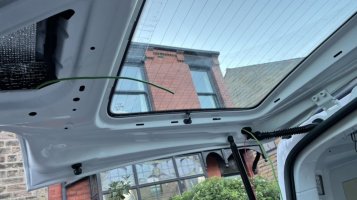

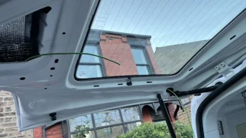

Its better to have distrust in your tailgate rather than rust@Pete C how easy was it to remove? My red rubber seal has split and I keep having to push it back in. I'm concerned that water will get in and distrust the inside of the tailgate.
Thanks.
Trivally easy. 2 bolts on the inside and it comes out. Release the clip on the electrical connector and it’s out.@Pete C how easy was it to remove? My red rubber seal has split and I keep having to push it back in. I'm concerned that water will get in and distrust the inside of the tailgate.
Thanks.

Try a speading a bit of washing up liquid on whatever your trying to push through and make sure what your pushinhg though has a rounded end, use insutaion tape to make the end more rounded if it hasnt, then more washing up liquid onto the wire as it pulls through..
You might have already tried this but thought I would mention it works usually.
