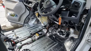

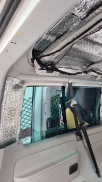

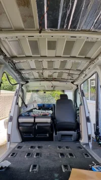

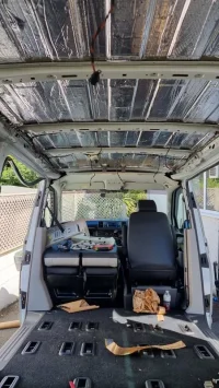

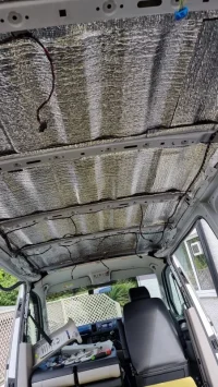

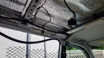

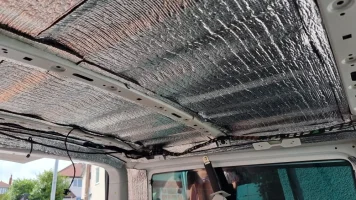

Well not just today but yesterday aswell. I removed the headlining seats and front seats, fitted shark fin aerial, sound deadened the roof and cab floor then insulated them. I've rebuilt most for now. Also half installed the halo 11 I had. Just need to get some screws and another cable then can finish stereo install. 20220710_140041.webp20220710_145353.webp20220710_161018.webp20220710_161025.webp20220710_162718.webp20220711_141609.webp

Well not just today but yesterday aswell. I removed the headlining seats and front seats, fitted shark fin aerial, sound deadened the roof and cab floor then insulated them. I've rebuilt most for now. Also half installed the halo 11 I had. Just need to get some screws and another cable then can finish stereo install. View attachment 164747View attachment 164751View attachment 164753View attachment 164752View attachment 164748View attachment 164750
Thatll have madea massive difference? keen to do mine, panel van so cab only
Yeah made a massive difference, only problem is because I've only done roof and cab area first the noise from the rear wheel Road noise is deafening. So I will be doing the rear floor, doors and rear inner arches very soon.
