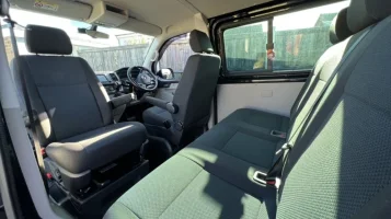

Like @t6blo, fitted the Kiravans RIB single passenger swivel (offset version). I was left at home to do DIY indoors whilst the wife and children spent day at outdoor swimming pool, so I sneaked this one in to get outside for a bit. Fortunately didn't't take too long, and went OK. All the YouTube install videos showed all the rear seats taken out, and I was hoping it would be possible with them still in situ - fortunately it was. I added masking tape to the seat trim to draw round the swivel base in advance of securing the bolts.
I've got heated seats and remembered to refer the connection. However, there was all sorts of additional wiring fuses underneath. Any clues as to what this may be?
A couple of questions - If anyone could shed any light, that'd be most appreciated.
does the seat actually lock in the 180 degrees rotated position?
I see it was recommended to use Loctite [text keeps changing to Lactate], but I haven't for the time being in case I opt for leisure battery etc. beneath. There is a fair amount of movement in the seat compared to standard, even with bolts tightened to the max. Does Loctite improve this greatly, and how are the bolts unscrewed if ever the seat is to be removed?
Here to hoping the wife doesn't notice the seat is slightly higher until such a time that she's a) in a good mood and b) we're in a situation when I can set and the benefits will be immediately obvious.
View attachment 164225View attachment 164226View attachment 164224View attachment 164223
No, it doesn’t lock in the swivelled position.
Loctite is unnecessary on the hex bolts as they have nylock nuts. You could use loctite on the others. Blue loctite is best as it will prevent the nuts from coming loose but you can still undo them with a spanner/socket if required. Red loctite is more permanent.
I also have heated seats so had to remember to unplug and pass through the hole. The rest of the wiring and fuses/relays can be ignored.
With the seat in the locked forward position there is no movement as the plates lock together with nylon guides. I felt abit of wobble (although I am 19st) when the seat was facing the rear - loctite will not help this. In my case losing about 5st might improve the wobble :whistle:
