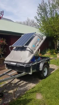

I spent the day under my van fitting 2 cables in flexible conduit from my leisure battery to 2 Anderson plugs mounted next to my tow ball. A power cable from the battery goes to the black Anderson plug and a solar cable from my mppt controller to the grey Anderson plug.
This is so when we take my trailer traveling on longer trips off grid I can run a fridge for drinks in it so the fridge in the van has food only.
Have fitted a solar panel to the top of the trailer to supplement the fixed panel on the van roof so I can hopefully keep up power to my leisure battery indefinitely when parked for an extended period.
When travelling in remote areas of Australia shops are far and few between so you need to be self sufficient.
If going on shorter trips I dont take the trailer as the van holds enough gear.20211016_173047.jpg20211016_173035.jpg20211007_130315.jpg
