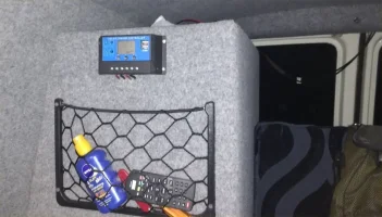

Sykaflexing a 100w Biard panel my lads camper roof... hope it sets overnight as he's off to Coed-Llandegla tomorrow with his cycling pals!
I've left an oil-filled rad running inside to keep the roof warmish.
and a cheap Chinese controller with homebrew bluetooth monitoring added... until he can afford a Victron...
...and we have sunshine!

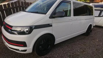

Added the black wrap to the front wing.
Saw this somewhere on a pic of another van & really liked it
Not so sure now !
Not so sure now !
I like that and works really well on a white van.
Have you thought about taking it along the whole side? I think it would look good. It would split the van and bring in the black wheels.
Edit. May sound daft but you could try it with gorilla tape first, stand back ( probably across the road would be best) so you don't see the imperfections and see how it looks before you commit.
really not sure about it yet. will give it a while & see

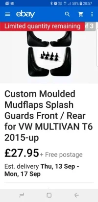

X4 New flexi mudflaps fitted hopfully will keep the crap off the van.
They even cope when fully aired out :thumbsup:
Appologies for the state of the van its filthy but not washing it till thursday, well thats what i keep telling myself:rofl:
Andy how did you find fitting them? I have some on shelf, I looked at fitting them but didn’t seem to fit right. Maybe I need to put more time into it. Hmmm.
