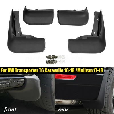

No rear bumpers not same shape.
Have read it fits with a gap and some modification.
Doubt it would look very good though.
It does fit ok small mod to cut about 1 cm square plastic out then add a bolt into the plastic bumper ( right underneath) I will try and get some pix
Are we talking for a barn door here? Be interested to see the pics if so.
That looks fine! They said would leave a gap. I’ll take that! :)
So you drilled a hole in the bumper where that silver screw is? Did you cut the mud flap at all?
Yep had to cut a 1 cm square next to the silver bolt I added and removed a 10mm strip to the right of the 2 screws shown in the first picture. The fronts were a straight bolt on and look really good as well as adding useful protection for my side bars
They look great, good job.
Where did you get yours from? Apologies if already mentioned.
