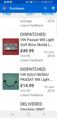

I've finally installed the ambient lighting unit in the cab area, cant wait to see what it looks like tonight, many thanks to @Deaky for the info on where to run the single wire to
Hi mate. I ran mine down the drivers a pillar and connected it to the ambient light circuit behind the dimmer (blue/grey wire)
The unit is off a passat w8 and buy the small loom to adapt it, ebay purchase for both brand newNow that's sounds like another little mod that needs doing![]()
Thats the inside of the unit m8 yes just fish the cable threw the roof lining no need to drop it.Sorry about all the questions, how long it the single wire or do I need to extend it? If I do what wire do I need to get? cheers
cheers thank for thatThats the inside of the unit m8 yes just fish the cable threw the roof lining no need to drop it.
0.5 0.75 or 1mm cable should be fine
Screen shot of ebay purchase so you know what to look for m8,
No problem m8cheers thank for that
