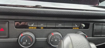

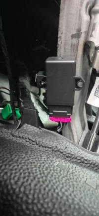

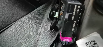

Oem heated seats retro fit on my t6.1.

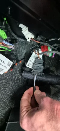

Relay module now delivered and fitted for completion.
Pretty straightforward wiring wise.
Coding/adaptions are not to difficult to do. But there are multiple settings to change for temperature settings and time settings to seats. As normal vctools for this. I'm sure vcds and obdeleven pro will work too.

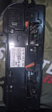

Important note, if you do ho this route and buy a used hvac module for seat heating. If it has been in a van that as been crashed, this locks out the module.
Providing your van as no errors on airbags or crash damaged data dtc's stored you just need to start the van and the engine run signal resets the hvac module. Then coding can commence afterward.
Part numbers in pics
hvac part number is for panel vans with solid Tailgate, AC. This does not have additional rear window heating button.
