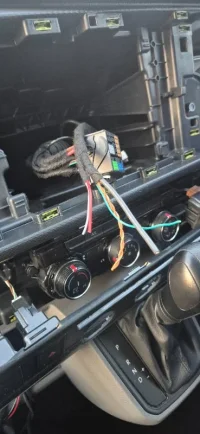

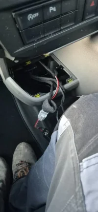

Not me, really helpful chap at ‘Voltwagon’ in congleton. Obvs need it to be dark now to determine if worth it. Um’d and ah’d for ages and flip flopped on options (thanks to folks on here for some thoughts too)
Dreadful flickering with forward facing lights. Not when engine off, ONLY when driving. Guy is going to look at obviously. But what do folks think? A dodgy connnection or something else load wise causing prob when engine running?
Pulse width modulation needs disabling with VCDS.
This is what chap has said to me pointing towards possible Pulse width modulation as cause-
Yes PWM (Pulse width modulation) is very common on lighting circuits. The control unit/relay is PWM compatible, thats why we've not had this issue in the past.
The lighting was ok when we had it working here, with the engine running.
If it was a PWM inflicted fault, it would have happened from the get go.
PWM isn't exclusive during engine running either, which points even more towards the control unit/relay box causing the fault
As soon as we have a unit available to us, we can address this 🙏.
