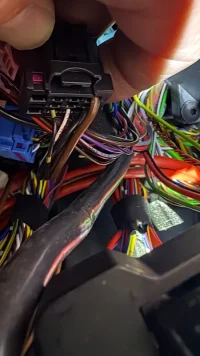

Finally got round to fixing the broken heater linkage which as many will know is an absolute pain the balls to extract, fettle with the replacement part from @romeorowe and then refit. Didn't help that I moronically trapped my index finger in the van door on Saturday morning which proved to make the process harder still as there's a lot of gripping and twisting required with index finger and thumb.
As I've now no temp control after fitting (it's on cold) I think I need to find a way to perform the 'adapt door end stops' process to finish the job - can this only be done in VCDS or is it available in Carista/ODB11? Any pointers would be much appreciated. 🙏
