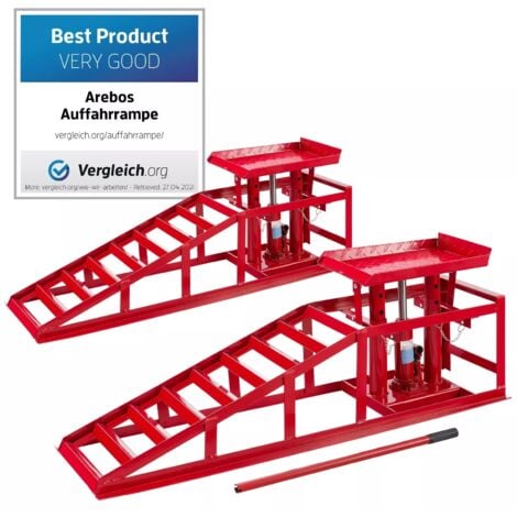

Does anyone know how high the van needs to be lifted to allow the tank to be dropped? I'm considering getting some maintenance ramps, but the few I've seen vary massively in height (and price). I've seen some fairly robust looking plastic ramps (link below), but they only lift the van 170mm. Would this be enough? Alternatively I've seen a ramp/bottle jack combination (link also below) which will lift up to 375mm.

The ramps with the hydraulic bottle jack lift as well are what I bought - the only problem that I found with them is that there isn't a positive stop for the tyre, I am going to have to weld a stop on the lifting platform so that you can feel when the wheel reaches it. It is it is very easy to run over as it is, especially if you have dsg and it lurches forward as you try to go another inch. They gave me plenty of room underneath when fitting my heater but I had my converter do the fuel tank take off on a 4 post lift to save me the job.
