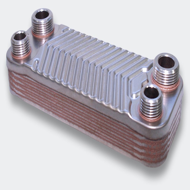

4. Well.. when i had all of this sorted out, i plan to take the water from the water tank with a 12vpump, take the water throught a heater exchanger like this one:
Material: Cobre, Acabado: Acero Inoxidable, Nº placas: 10, Medidas: 19x7x3cm, Rendimiento: 22 kW, Superficie intercambio: 0,18 litros
tucalentadoreconomico.es
Connect the entry and output of the exchanger the water from the tank and take the coolant from the webasto output (warm), take into the exchanger and take it back to the coolant circuit. i would like to modify the coolant circuit as less as i could as all we all know how delicate our vans are....
