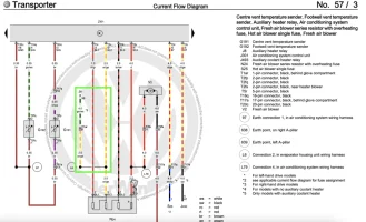

Someone messaged me asking for details on the blower wiring for Climatic air-conditioning. I'll post it here in case anyone else is interested in the future.
On the factory setup, the blower is controlled by the auxiliary heater using relay J8.
Unfortunately though, the wiring from the auxiliary heater to T17p connector didn't exist (on my van at least). I didn't fancy having to run this wire under the van to the heater, so instead I connected the relay coil to pin 3 of the Telestart receiver. This pin gives +12V when the heater is switched on. Which means the blower comes on immediately when the heater is starting up, whereas on the factory setup the blower doesn't start until the cooling water reaches something like 40 degrees. But I can live with this for the amount of hassle it saved.
The output contact of the relay needs to be supplied by a 30A fused supply from your leisure battery (it will drain your starter battery in no time). I ran 4mm2 wire from the relay to the back of the air conditioning control panel, and spliced this into the yellow/orange wire (important: this must be a good quality splice connector, a high resistance connection will cause issues due to the high current). See the drawing below.
Regarding coding, I had to keep it so that the heater thinks the blower is started via CAN bus. The heater is smart enough to detect that hardwired connection from the heater to relay J8 is not connected, and this blocks the heater from starting.
