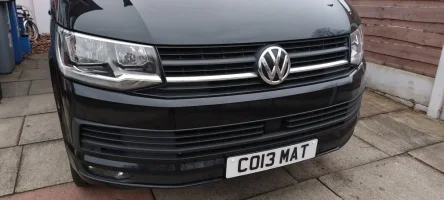

Now that I have gone from h4 to h7, when the headlight switch is in the auto position the drls aren't on but the just dipped and side lights are (in daylight). When I move from auto to side position the drls come on with just side lights.
Switch in 0 position drls come on.
Is this normal behaviour for h7 headlights?

I'm guessing the daylight isnt bright enough to turn the dipped headlights off today. Check it on a sunnier day.
I'm surprised its that sensitive. Wonder if the lux sensor can be adjusted to so it activates a little darker
As @Skyliner33 said above. The threshold isn't really adajustable. Well, adapting windscreen type in RLS sensor might have some effect - possibly just "wrong" way I'm afraid.
That's correct.
Anyways, if you would like to have in side position only plain side lights - unticking byte 23 bit 5 would do that.
