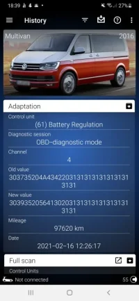

As I had a few engine faults recently I had obdeleven connected and noticed the battery voltage immediately after engine off is 12v and then dropping to about 11.8.
Normal?? I didn't notice or pay attention in the past.

Well I'm getting 14.6v with engine running, I coded the larger capacity battery, think I did it properly. Would be interesting if anyone else with a varta g14 95ah battery could check their battery voltage. Maybe didn't code it properly.........

Thanks, will try the fan at 2 or above.. trying to work out how I can perform data logging with obdeleven and see what it says
