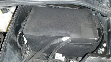

I changed my battery for the larger 95ah version. The battery comes out at an angle and getting the new one in is a bit of a pull there push there affair but easy enough.
Watch you don't trap the -ve BMS cable at the rear right corner (viewed from driving direction) rear left from front of van.
Also make sure the rear of the battery is secured in the holding lip.
I could reuse the insulation jacket, small gap in it is at the rear left corner and the end of the jacket are held together with a high bond fabric tape.
I did make a mistake..... I didn't look at the cut out alignment for the forward battery securing tab. I couldn't be bothered to take the battery out and retape the jacket so left it as it was.
