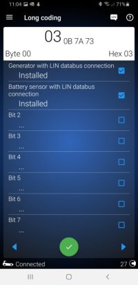

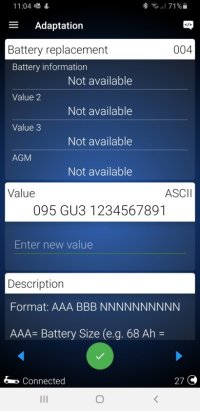

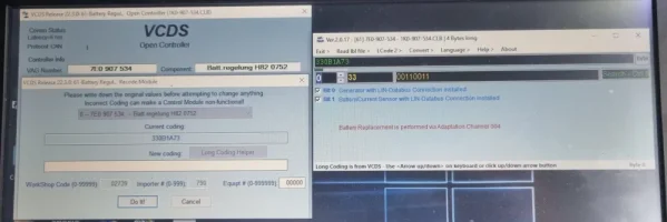

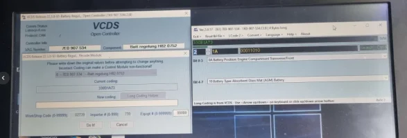

Just fitted the exide 95 to my van. Using obdeleven to code it in. Managed to change the battery replacement to the correct value.
However I am unable to find the location on obdeleven to change the battery to agm.
I have looked through Elduderino's guide on page 5 of this thread which has been a great help so far. However that guide tells me go back to battery regulation and choose long coding to change the battery type. When I do that my long coding page looks nothing like his.
I have ebdeleven pro on android.
Below are screenshots of my battery value and battery long coding page.
Any help in locating the correct page for battery type, on ebdeleven greatly appreciated.
Battery type is in Module 61-Battery Regul. Coding bits 4-7 in byte 2 from 70 EFB to 10 AGM. (See first page of this thread) However if your old battery was AGM and the new one is AGM then there's no need to change anything
Thanks once again I have managed to get to it with your help. Thank you for the fast response.

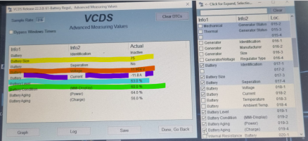

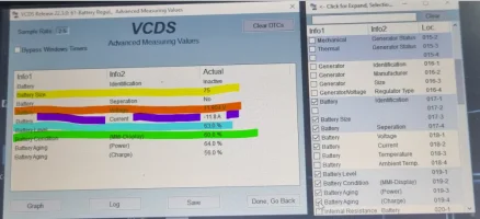

VCDS --> module 61
Click Adv Meas Values . . .
select the data blocks you want to see . .

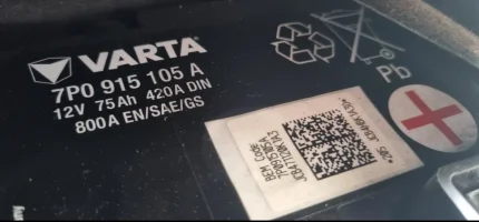

here is my van 2018 year with a VARTA 75Ah factory battery.
just sitting on IGN, engine not running.
The ECU has this data stored:
yellow - battery size @ 75Ah
green - battery SOH - 60%
blue - battery SOC - 63%
orange - battery voltage - 11.94v
ppl - battery current IN/OUT - -11.8 discharging as engine not running.

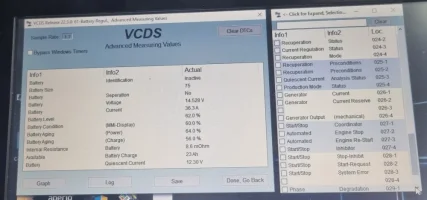

now with engine running.
we can see the battery taking in an initial 36.3A current from the alternator.
this is the 4year old VARTA AGM 75Ah,
