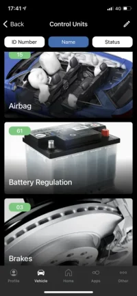

What's on the previous screen - before executing the adaptation?

This one? Or did that happen when entering into Adaptations?Screen before is Control units/ choose battery regulation
Wish I could be of more help. I can only tell you what works with my Pro device.(activated)I don't have a battery regulation unit. Its the latest version of the app. I have an active pro version
NO battery regulation unit??? I'm afraid then there is no battery coding available. Not T6?I don't have a battery regulation unit. Its the latest version of the app. I have an active pro version
