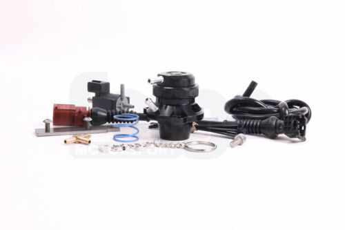

I'm also about to pull the trigger on a Forge Blow Off valve kit, are they worth it?
As the engine has a MAFF if you fit a BOV you need to feed POV exhaust back into the inlet pipe after the MAFF rather than vent straight out.
That is because the air/fuel has already been metered thus you will upset the mixture if you just vent the excess air pressure.

I imagine that's what the full kit does...
The description says its an atmospheric valve then goes onto say "Like our recirculating valve" so it maybe they do 2 versions and you need to contact them to clarify..
Ohhhh, didn't see that one. That does complicate things. Think I'll have to contact Forge.
