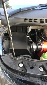

Hi if anyone needs any help with t6 tsi tunning I have a 430bhp beast with a custom air box tte450 turbo custom down pipe full miltek
High pressure fuel pump Wagner intercooler mrc mapping few other bits ap brakes
Did u put injectors in it or are they stock
