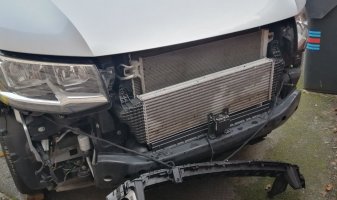

So I went with an ITG panel filter and drilled the airbox, ITG are very good filters used by motorsport sections. I used one of thier panel filters on my 500bhp RS4 for years with no issues.
I also fitted the Evo1 intercooler, again I knew Wagner from Audi tuning and like there quality. Fair bit bigger than std. I got a Revo1 map and the guy doing it said the IAT's were nice a low. Stock turbo etc so wanted to keep everything nice and safe. Intercooler sticks below bumper bar as well. Oh and some Forge boost hoses as well.

By installing a bigger intercooler is is physically blocking more of the AC condenser and the engine coolant radiator plus dissapating more heat into the air flow with increased engine performance.
What’s the effect on the AC and engine cooling?
