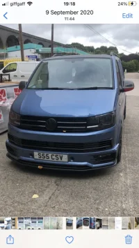

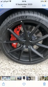

Hi if anyone needs any help with t6 tsi tunning I have a 430bhp beast with a custom air box tte450 turbo custom down pipe full miltek
High pressure fuel pump Wagner intercooler mrc mapping few other bits ap brakes
Hi @Samt6tsi sounds impressive. Is it DSG or manual? Vulgar question but what did it all cost?
